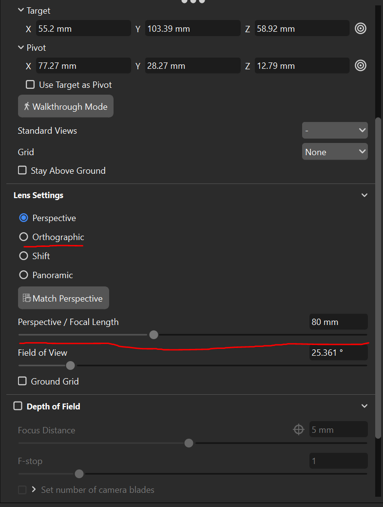

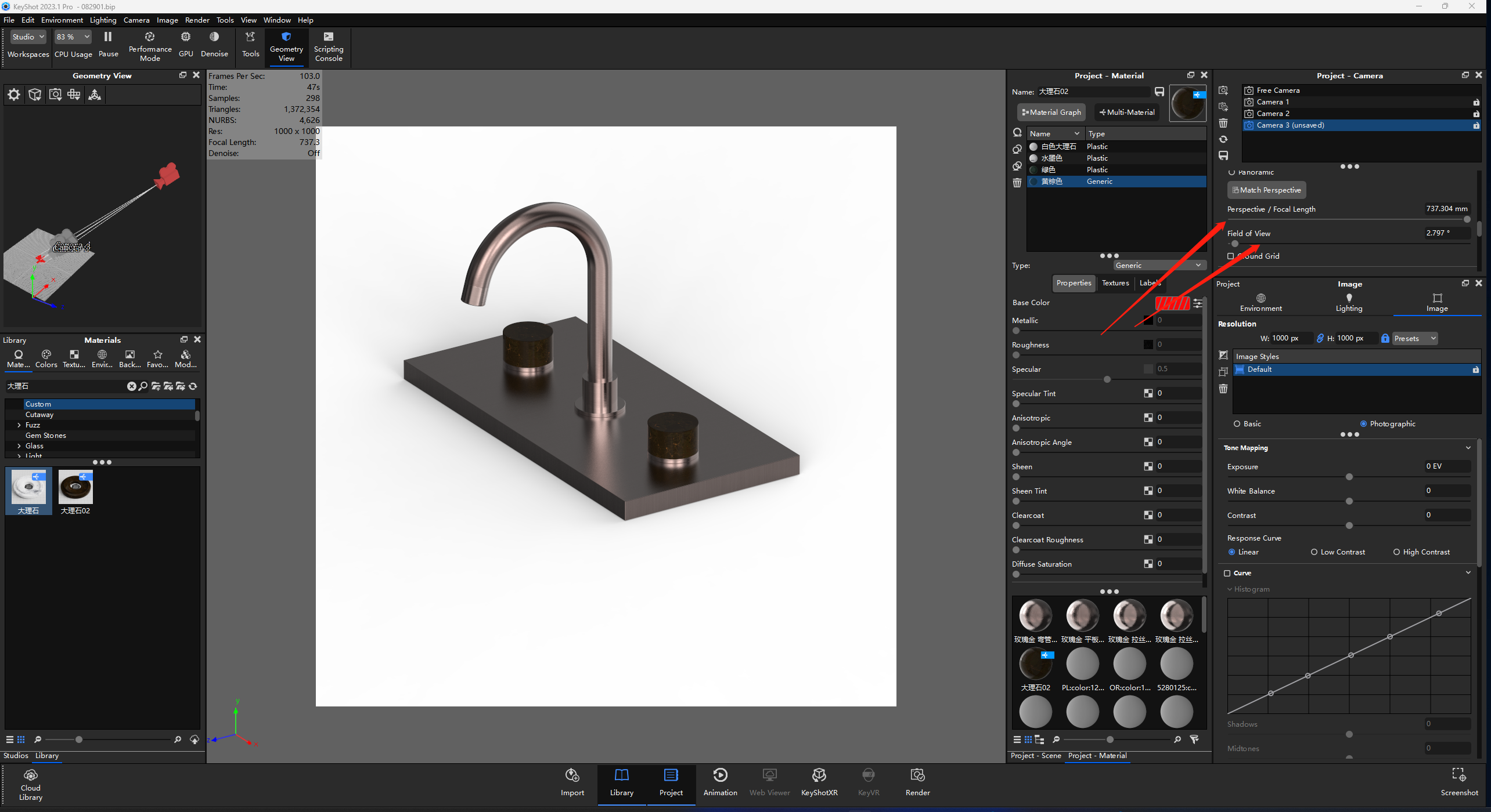

could someone explain why the camera position in the geometry view is so far although the ambient scene is’nt so big and the point of view is pretty much near the object ?

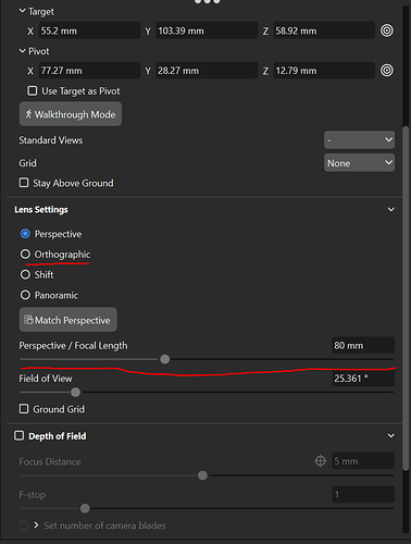

It seems you are using a very very long focal length. If you go to your camera tab, made the focal length wider, or if you are aiming for an orthographic perspective, select that option over perspective.
I agree with what Oliver Yu said, just adjust the Focal Length and field of View as you got a wrong perspective view now.

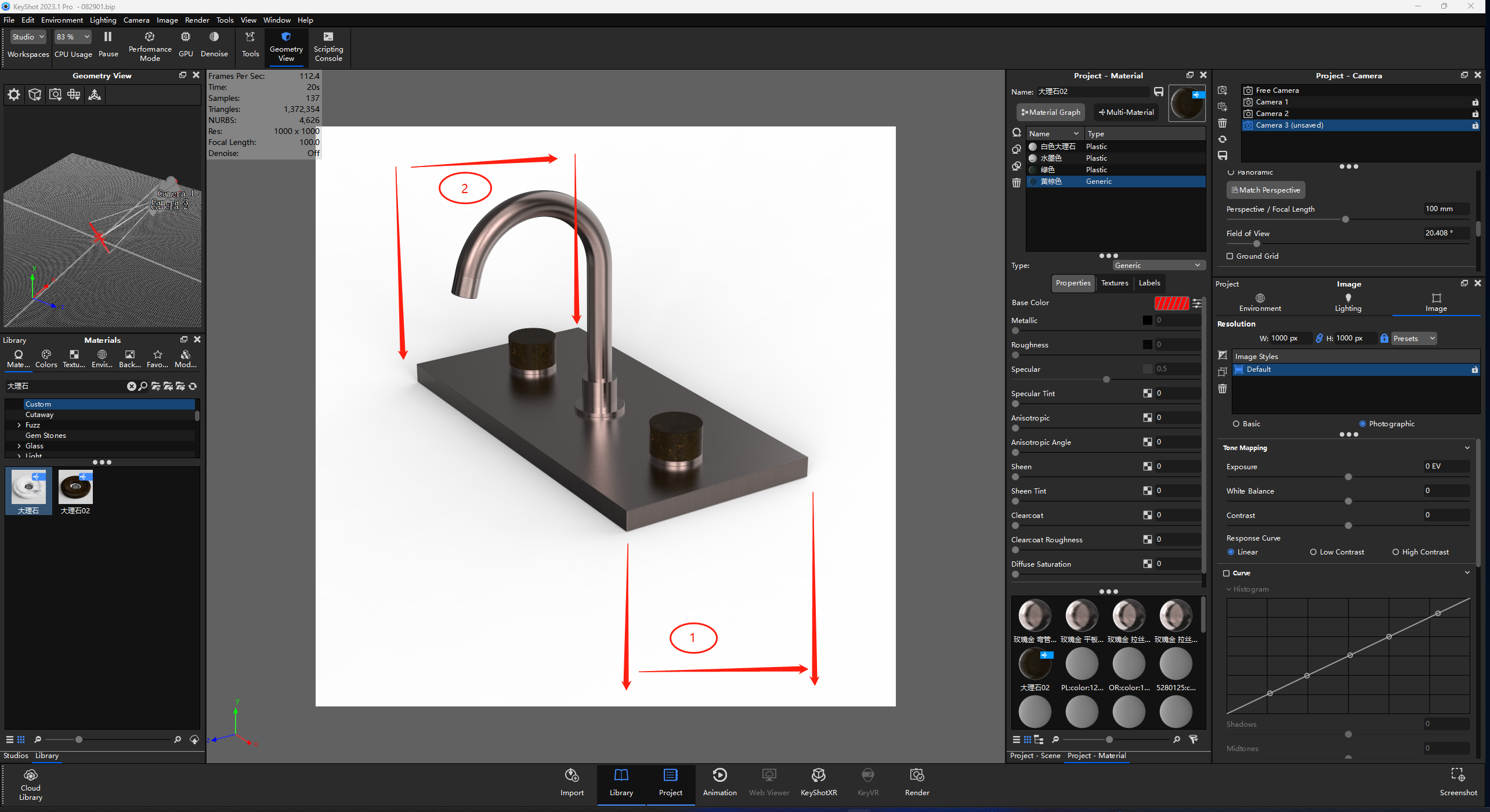

Being a right perspective view, the length of 1st place should be longer than the 2nd
